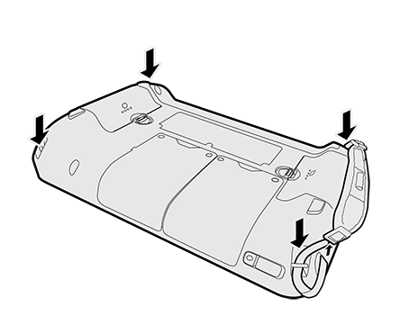

Attaching the handstrap
Attach the handstrap to the left or the right side of the device, according to your personal preference. To ensure a good fit:
  1. Thread one end of the handstrap ribbon through the bottom handstrap slot on the back left or right of the device; thread from the center of the device outward, as illustrated.
  2. Pull the end of the ribbon back towards the center of the handstrap and feed it up, over, and down through the lock buckle on the handstrap and pull it tight.
  3. Thread the ribbon at the other end of the handstrap through the top handstrap slot; thread from the center of the device outward.
  4. Pull the end of the ribbon back towards the center of the handstrap and feed it up, over, and down through the lock buckle on the handstrap and pull it as tight as is comfortable for your hand.
    If required, use a small blunt tool to push the ribbons through the handstrap slots on the device. Do not use a sharp tool.
When using the handstrap, the device should sit firmly in the hand.
