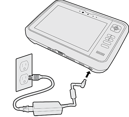

Charging the batteries in the device
- Connect the appropriate international plug adapter for your region to the AC adapter.
Connect the power cord to the charging port on the device.
Plug the power supply into an electrical outlet.
