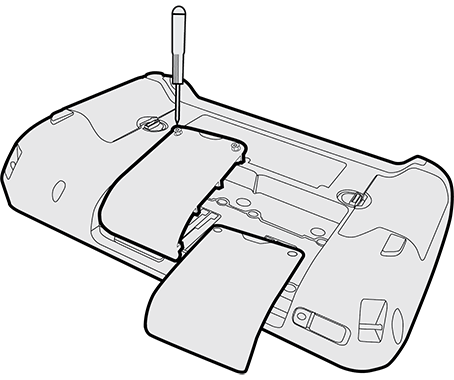

  1. If the device is on, turn it off; tap / Power/ Shut down.
  2. Using a Phillips screwdriver, loosen the screws to remove both the module bay covers from the back of the device. Or, if you are using Empower modules, remove them in the same way.

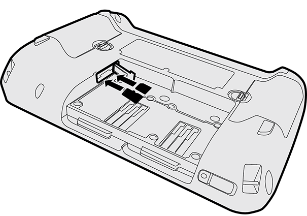

  3. Flip the SD/SIM bay door open, and insert the SD card and the SIM card into their respective slots.
  4. Close the SD/SIM bay door.
  5. Replace the module bay covers, or if using modules, re-attach them. See Using Empower modules.
