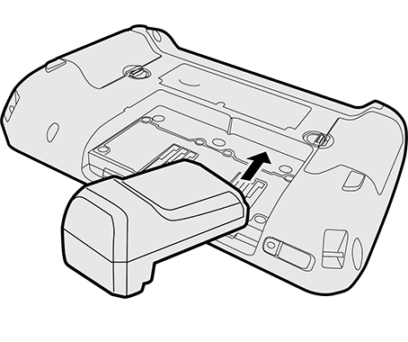

  2. Turn the device over, and using a Phillips #1 screwdriver, loosen the 2 screws on one or both Empower module bay cover(s) to remove it/them.
    Store the covers somewhere safe for future use if needed.
    Before you remove a module from the device, make sure the device is powered off. Reattach the module bay cover when no module is attached.
  3. Hook the Empower module onto the device, ensuring that the slots on the top of the device line up with those on the Empower module.
  4. Tighten the 2 captive screws at the bottom of the Empower module using a Phillips #1 screwdriver. Do not overtighten the screws.
