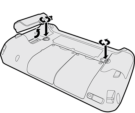

Installing the batteries
For either battery:
  1. Turn the battery latch 180° anticlockwise until the flat edge aligns with the battery opening.
    You can use a coin or the top of the stylus to do this.
  2. Insert the battery, then turn the battery latch 180° clockwise to lock the battery in place.

To hot-swap the batteries, replace one battery at a time:
  1. With the batteries in the device, press the charge button on each battery to check its charge level (see Checking the battery charge level). Make sure there is enough charge in one of the batteries to keep the device running. Replace the battery with the lowest charge first.
  2. For the battery with the lowest charge, turn the battery latch 180° anticlockwise until the flat edge aligns with a battery opening, then remove the battery.
  3. Replace this battery with a fully charged battery.
  4. Turn the battery latch 180° clockwise to lock the battery in place.
